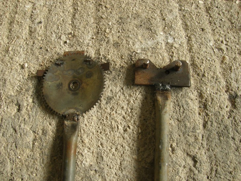

    make something like this out of two bits of bar and 3 bolts. Doube up on the top bolts and leave them sticking out so you can locate them in the holes in the outer clutch bell. Make the long arm too long so it catches on the floor. This will stop the drum rotating...then you can undo the nut

  12. Stathis
    1,720
    Nrg Power 70cc
    have a look at my homemade tools haha :p the one with the circle thing doesnt work correct though... needs a makeover since its a pain in the ass to undo and do the bolt :p
