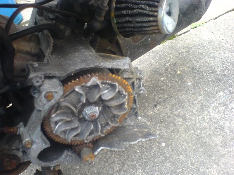

  15. wobbly_trials
    one thing is crucial, don't just ignore the vibrations in the hope that they will go away or you may end up like this:
