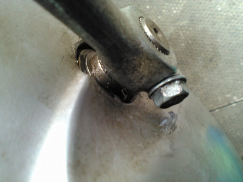

    Mmmhhh.......I gotta feeling that I may have put this back together wrong......take it apart again tomorrow and try again...... WP_20180310_002.jpg

  8. Mark Emerson Trentham
    Have an '86' Vision & the return spring is under some quite serious tension + ratchet needs to be located properly - so it's not just the spring that could be weak.
    You may also want to check how far the ratchet range of movement is/without the spring fitted - to get an idea of how far it can move without restriction of movement via surrounding parts.;).

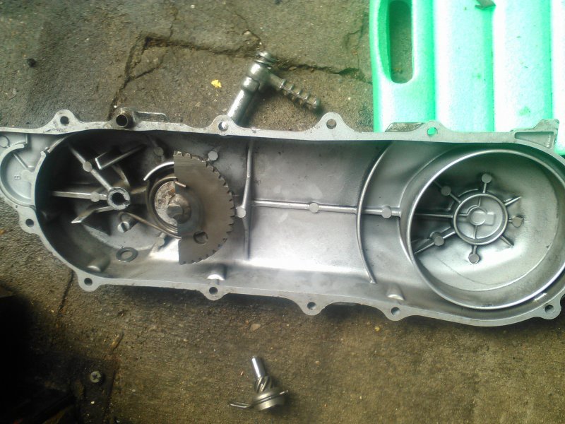

  15. Del Sky
    Del Sky Active Member
    262
    A "Chinese Thing"
    O.K....A lesson learned !!....or rather, a lesson REMEMBERED, if you are gonna do something, do it PROPERLY !!....after watching a Youtube video, on kickstart spring replacement, I discovered that the spring should be under some tension when it goes in, so took the cover of mine again, took it apart, and re-assembled it PROPERLY.....I also discovered that the small circlip on the kickstart shaft, was not sitting in it's groove, thus allowing movement, and allowing the spring to go UNDER the half moon thing ......all back together now and working fine.....a £13 lesson, 6 something for spring, six something delivery....I won't cancel it, it may prove useful one day.....if this helps someone, then all well and good. WP_20180313_001.jpg
