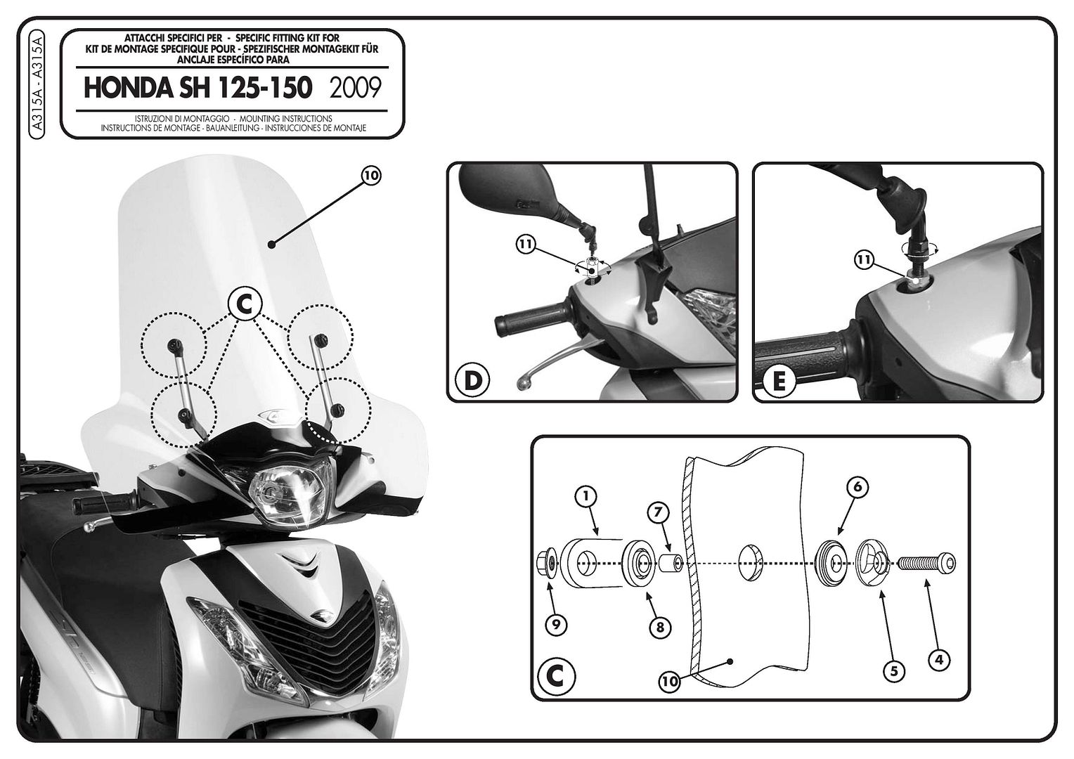

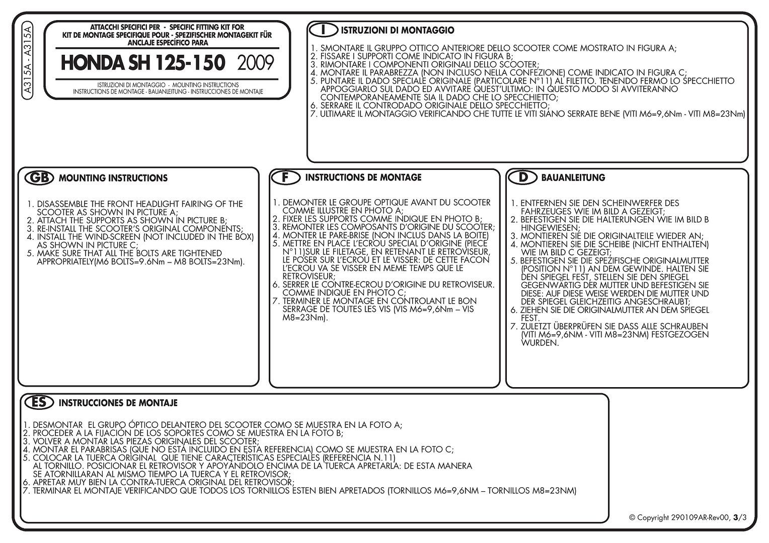

    I found these for the 2009 model.. I guess the mounting procedure will be similar.

    just the ticket thanks bet your life they change it this year just my luck

    they all fit pretty much the same, you either take the front panel and put some brackets under it, or you use some cleverly hidden mount holes that are under the front panle, ive done a few screens on a few different bikes.

    dont know were you manage to find all this infobut im bloody grateful to you thanks again wolf will have to see if a 2015 scooter has any fitting holes , I think you have cracked it
