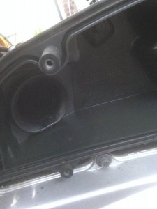

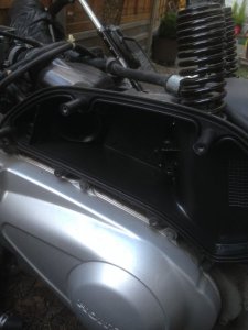

    I have check almost everywhere.I have spare engine and it's easy to check around but still can't find.been in couple motorbike services and even from there they don't know where it's located.I have tried to order today from big motorcycle dealer and from there didn't find in sistem.my scooter doesn't work properly from 30 to 60 degrees roughly.when it's cold work properly and when it's hot same but just before first line of temperature scale start giving me problems and for that reason I was thinking its IAT sensor.i have change plug and cables I have add fuel cleaner but nothing help.just wanna change the IAT sensor but can't find.if anybody can help will appreciate. Thanks

    Hi mate do you think is possible to not exist this sensor on Honda ps 125.I have call couple of dealers and they didn't find.i have remove all air box and check everywhere and didn't find
  16. m1ck_t
    I know that the throttle bodies/assy is notorious for going bad on the ps , sh and fes/s wing models . Have replaced many over the years
