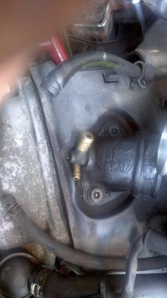

    lol thought you heard the last of me uh lol anyways had a few days break from it and the started again today, what i have discovered is that one of the rubber pipes the inlet pipe at the front with the two metal bit that the fuel hoses connect to at the front of the carboretter as its is seated has some majorr cracks on it i mean like big time iwas glad when i saw this as i thought that maybe the fault and i wouldnt have to get mental on the carbs, but my joy was shortlived when i saw what looked like it was attched with a star like nut or something forgive my ignorance but what tool pulls that apart thought it might be a torque srcew but it has a pin in the middle ahhh i have managed to up load it if you or anyone else knows what it is ill be greateful oh if you zoom in you can see the cracks too any i hope all is well and thanks once again for the patience
    peace out
  10. Todi-Corsa
    Todi-Corsa 4 stroke thumper
    336
    Have to be quick as I'm on the phone and that battery is about to go flat :D that sounds like a security torx not a normal torx mate not much diffrence in price thou :)
