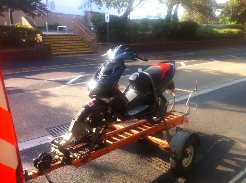

    Right my little scooter buddies, couple days ago my bike wouldn't start, took the spark plug out and cleaned it up (didn't have a spare so I ordered 10 more) put it back in and it started.
    This morning I rode it to work, went to ride it home again and it wouldn't start, my brother came down with a new spark plug, changed it and still not starting!!
    Phoned rac, they came out, said there's no spark.... Never had an issue with it starting before.
    Been told its either the ht lead, coil or starter relay...
    Any one got any ideas??
    Fucking devastated tbh :(
    At least I got a ride home...
