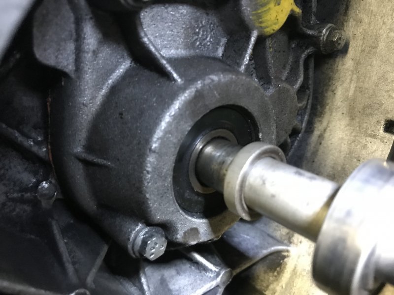

    i have this problem which i cant solve and i tried everything that came to my mind. When i tighten the bolt that comes on the clutch bell the bell stops to spin freely and it starts to spin with the clutch pulley all together and blocks the rear wheel. I’ve tried tightening the clutch assembely, puting diferent size bushing behind the pulley and i cant figure it out please someone help me..

    Are you using the right clutch? Rolling or non-rolling type? The non rolling hs a spacer tube in the center.

    Yes its the right one, it worked before i disasembeld it, its non roling. Spacer in the center? The one on the picture?

    Is the big clutch nut tight?

    Yes

    Have you tried another clutch?
