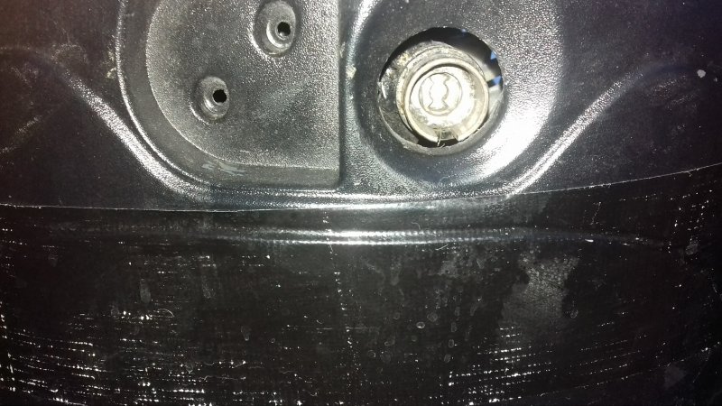

    Where the ignition should go there is just this hole
  6. Stevep
    Yup, when you remove the front and rear panels it will expose all of where the new stuff will go. The large black part with the key and it's surround will cover that hole.

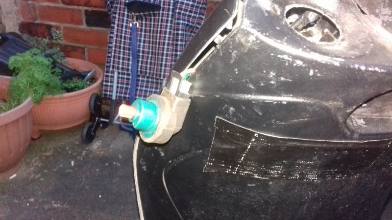

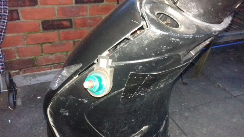

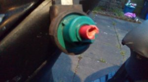

    Hi. Thanks for the reply. That is a good video. Thanks. But there dose the green bit with red switch go
    Thanks
    see pics below
  8. Stevep
    the other end of the tube from the front bit, you'll see it when you take the panels off

    Hi Steve.
    I.dont have one of those clips. One came with the new green ignition switch. Its a different shape. Where could I get one from or could I just improvise with something.
    Thanks.

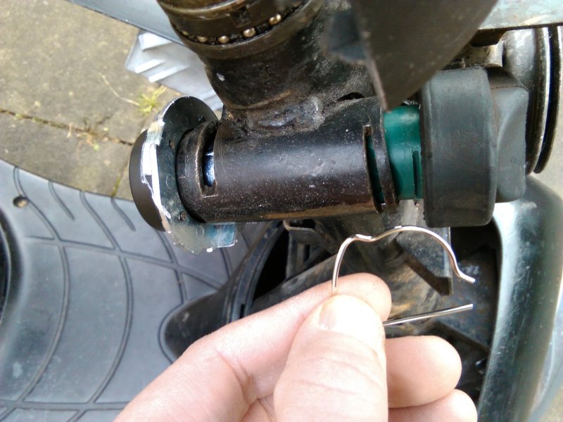

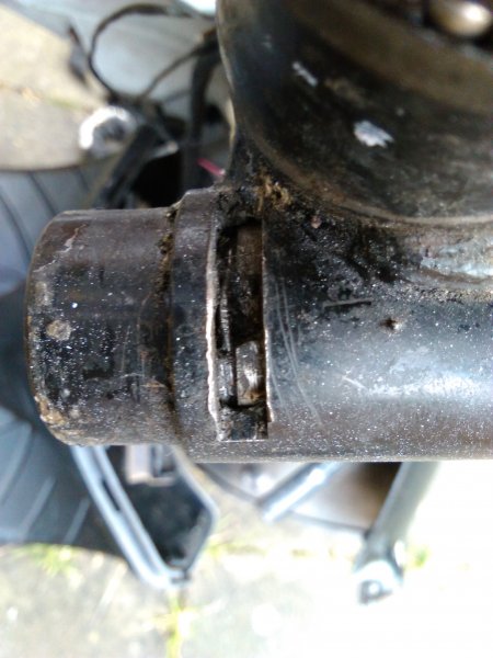

    Where dose this clip go to hold switch in please ?
    Also, Is this a clip inside to hold barrel lock ?
  11. Stevep
    The clip in your hand secures the green block at the back of the tube.

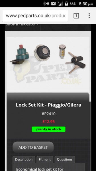

    See that slot in the front? the clip goes through two little holes in that slot to secure the key barrel
    I think pedparts do the clips separately now
