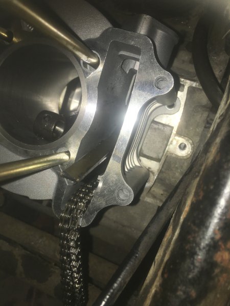

    Hi guy iv recently got a 150cc bore kit for my lexmoto dart 125 the place I got it from says it fits my bike bla bla the engine code is 152qmi-a and the bore kit matches the engine code yet seems it does not fit here is. Pic of it hope some one can help thanks

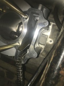

    737F6C4D-EA8B-494E-84BD-AE4F93A86D84.jpeg The cylinder don’t seem to fit right
  4. MARSH
    MARSH Whooooo!
    3,266
    Piaggio Typhoon
    Measure the spigot diameter (bottom of barrel) then mouth of cases, the cases may need machining out. I did it with a 150cc kit on a CG 125 engine.
  5. scubabiker
    Is that all the way down to the case?
  6. Bazza900
    Bazza900 New Member
    4
    Contacted the seller and apparently there is 2 engines for my model bike and I have the newer one so don’t fit
