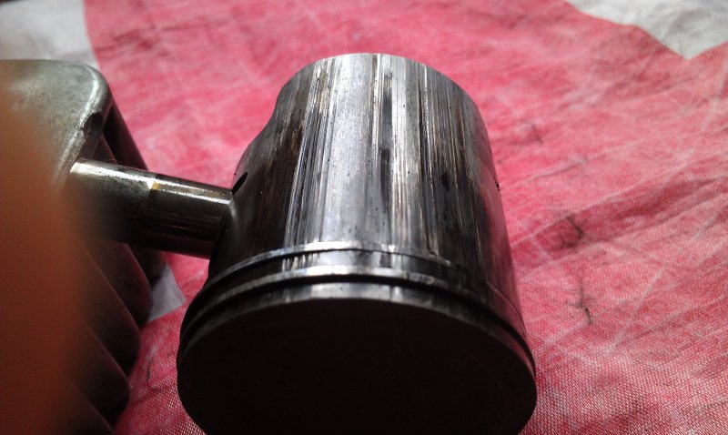

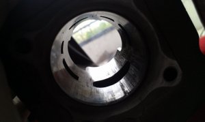

    coz i want do something some one wont have the same as and was gunna bore it to 120cc as iv seen a head for the 100cc engine so that why i wanted to know if i can put it in a honda engine and plus i have a honda x8r engine that near anoth the same as speed fight engine and its stripped right down to engine casing and that why i wanted to convert it and put 100cc crankshaft and then the piston kit but never mind ill work on a diffrent project then and i have a 70cc but it had a 70cc aftermarket ebay cylinder kit on it and now waiting for my malossi 70cc cylinder kit to come and my aftermarket one is going in my other post if you wonna see the damage of it lool BARREL 1.jpg PISTON 3.jpg

    dont think so mate the head is the wrong size if you look at the pics the barrel and piston one set so the head i was given it by my mate who said it might be for a 70cc not sure so i use it anyway, im taking my kit to the garage see what he says and does anyone know what torque you do the head up at ????
