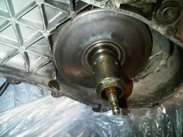

    Hi everyone... Ive just taken the engine out of my runner 50 and i was under the impression that this plate should just slide off but it doesnt and i really dont want to brake it so any ideas would be helpful....

    why is your torque driver stuck on ? there is a tool you can use i cant remember what its called its got and massive bolt in the middle and 3 claws on the outside you screw it down and it will pull it off

    ignore the guide that is the tool to use

    Hi thanks for the replys i had a long walk down an expensive tool store lol and got myself a gear puller and managed to remove my torque driver i dont think that bad boy has ever been off lol but its all good now and my engine cases have been under the cleaning brushes today.
