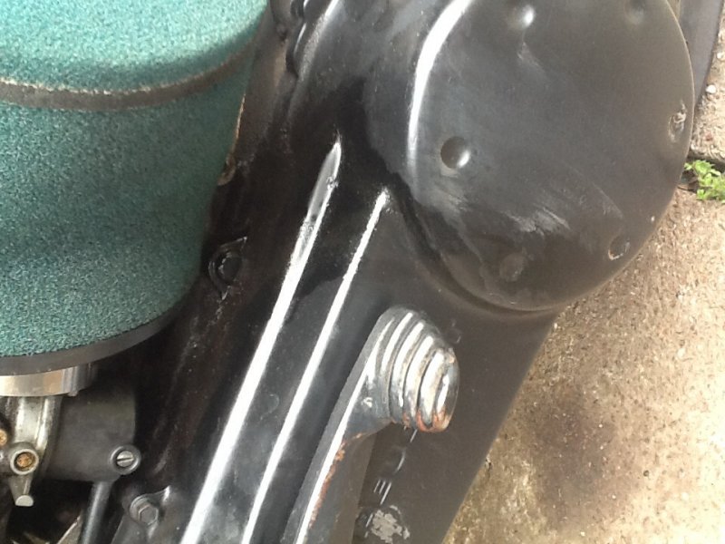

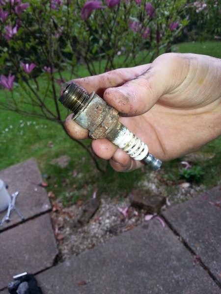

    Hi I have a speedfight2 silver sport ac with a Leo Vince TT sports exhaust with stage 6 foam airfilter running a 100 main jet, I have recently been having problems trying to start the bike as it just clicks on electric start and the motor does not start it will only start after trying lots of time then when the motor finally starts I have to keep revving the bike really fast like (I am tossing bike off or sommet) till it finally builds up enough revs to keep the motor running I have a pic of my spark plug below and all this oil what I have no idea is coming from below

    Well, that plugs seen better days, hasn't it.
    Change it.
    If its a 50cc then a 100 main jet is WAAAAY too bigand its bogging, getting too much fuel until the air can catch up with it.

    The oil is coming from the blowback out the back of the carb, soaking through the filter and dripping onto the case.

    That filter is properly filthy with oil and petrol now, so best chuck it and replace. The problem with those types of filters is the rain gets sucked in too easy. You may not realise it, or think that it does, but a drop of rain can sit in the connecting rubber and then when you give it the beans, it gets sucked in straight through the carb and onto the piston, then kiss goodbye to the rings and barrel. Thats why we say stick with the standard airbox as much as possible.
