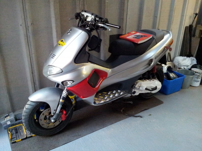

  4. rendersonique
    rendersonique Member
    65
