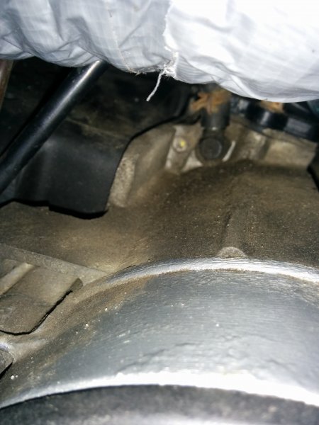

  7. Nick Kruklinski
    Nick Kruklinski Member
    81
    Typhoon XR 125
    Is this the one

  10. MARSH
    MARSH Whooooo!
    3,266
    Piaggio Typhoon
    Yes, that's the pipe.Look's like it's still on so? Need to look a bit deeper! Is it flooded?
