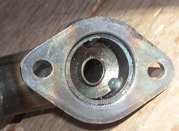

    Does it come restricted? If so how do I derestrict it? I heard it has a cone in the expansion chamber which I assume is difficult to remove?

    aerox
    ye most exaust have restrictors there not hard to remove just a cone on the manifold just cut it off with a dremal

    All e-marked road legal aftermarket exhausts are restricted otherwise they wouldn't get an e-mark. Most of them it's a welded in the downpipe and you have to use a dremel or something similar to grind out the welds. The Yasuni Z also has one in the end can. They are designed so they are easy to remove.
