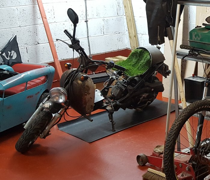

Hi folks, I'm Kenny. Here's my pulse scout with the plastic pulled off and some other bits stuck on. I call it the wild turkey. I've just stuck a big bore kit onto it and can't get it started again but that's for a different post. I'm a car guy but thought this would be fun and I was right. I used to restore vw beetles for a living but am now the sculpture technician at the local uni.

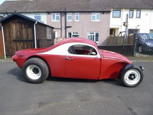

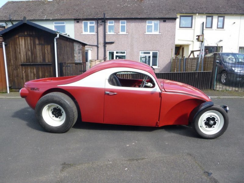

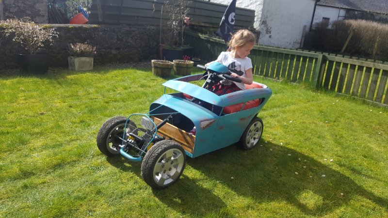

I love making things. Here's my pick up hot rod beetle (now sold to fund my garage) and the second trolley I built for my daughter.

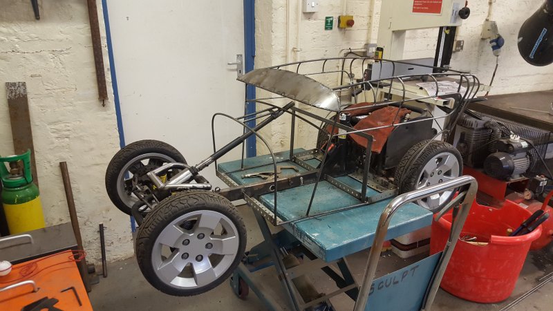

The time to build is going to vary massively on how you go about it. I've seen quite a few of those fibreglass vw splitties with the mobility scooter almost un-modified underneath. I modified the steering/controls column to lay back so that it'd go into the body before it tilts up then defined the edges of the floor, bent some rod for a frame and filled in the gaps with .8mm sheet. Then there's a seat to make and upholster and paint for the body. I recon there's about 40hrs and £350 in that one including the £250 initial purchase price. Good exercise just to tinker away with as and when. To me the most important thing is that I could fit into it too, why should little people have all the fun. What sort of thing can you see your spare parts making? petrol electric body style?
