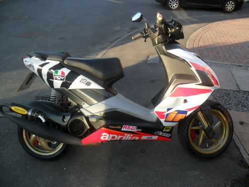

    hi my names stephen i live in durham just outside of new castle and am i scooter man :D i have been with scooter shack for quite some time but never really had anything good to post about but now my new shape sr 172 is on the road i think its time to show it to the world i took my 55plate sr50 factory r carb and droped the old engine out cut up and braced the frame and put a 2001 sr125 engine init currently running: mallosi mhr 172, delroto PHBL 26mm, pm tuning carbon reads and open intake manifold, mallosi delta clutch, mallosi drive belt, pm tuning pro street varitor, pm tuning clutch bell, mallosi secondry gearup kit, and a pm55 exhaust and thats about it shes my baby and goes like a rocket cant keep the frount wheel on the ground :D so far shes ben clocked at 90 flat out but is going to be booked in to shiny red for some porting and flowing and dyno set up soooooon so we shall see curently running 19.6bhp

    damn thats a nice ride right there man! it must be quite powerfull haha :p
