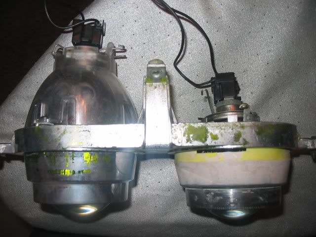

  9. lukeyboixrace
    lukeyboixrace Member
    211
    here...
    basically if you look the bulb for the main beam is seated much further into the headlight...so i had to extend the other dipped beam piece that i cut off a spare set of lights i had to make it fit.
    but now, the beams gone funny.....
    so where exactly am i going to glue the cone?
    to the inside of the lens? :wtf:

  11. alexsr70
    alexsr70 New Member
    2,039
    ok so you want both lights on at the same time in the dipped position?
  12. lukeyboixrace
    211
    :rofl: ahh i must be talking like a right dodo.
    i'll try explain as clear and crisp as possible.
    my main beam is focusing too much onto one spot.
    even though it has the cap on the bulb....
    i just wanted to know if there was a way i could make the beam wider so it's not onto one spot.

    rite ok one last question, hav u got a pic of the lights before you modded em?
    cos if youve moved the lense on the right light forward then your gona need to move bulb aswell
    go get a torch and wind it forward and backwards, every mm makes a difference as you will notice. Apply EXACTLY the same physics to what youve done, its hard to explain what you need to do when i havent touch them lights but physics NEVER change

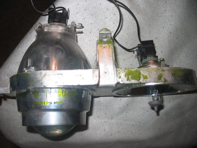

  16. lukeyboixrace
    211
    yes mate.....the picture above...the one without the cover on...thats how the lights are standard....just the reflective backing ;)
    thats the whole reason i've done this mod....so i can have it look as if i have two dipped beams...as it looks much better.....BUT the main reason being, with the cover over this bulb also it will protect the bulb from rain as i no longer have a lens on it do i as i cut it to form the new shape of the lights
    so basically before...there was no lens....nothing to direct the beam except the reflective backing...so now that i've put this lens on it's buggered up the beam....and now it shines to a point......but with the tests i carried out with the lens and a bulb....it appears if i move the bulb close to the lens it should make the beam wider....so it should work...i'll try it tomorrow :nerd:

  19. alexsr70
    alexsr70 New Member
    2,039
    ahhh right ok well FULL beam as you no it is full light hence the BIG mirror, the dipped has a lense to direct light down not just out and forward. the full beam is a simpler technology than the dipped beam....
    basically look at both lenses and see the difference, cant really see how your gona sort it tbh cos ur using the same lenses :confused:
    but seems the torch theory and lenses are your best bet to test and adapt, personally can see it being alot bit of fucking about.....
    why not just convert so both are dipped beams? full beam is shit on my ped, prefer dipped..... would look better having both lights on at the same time and would probably be easier
