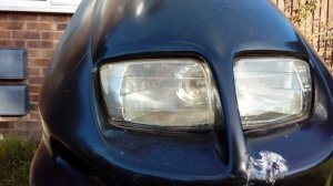

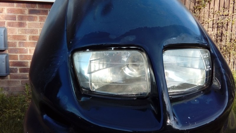

Well this morning i spent 24 mins on the lenses ( the left one) with the toothpaste and circular rubbing motion using a decent cloth, about four applications of toothpaste to stop it being a dry rub in. and well the results ........ To be honest i cannot tell a difference between the before and after images i snapped, they both look the same , so myth is busted it did NOT work for me but maybe you have to spend like three hours rubbing those lenses to get anything like they show on the interweb. But one good thing came out of it, my scooter has this awesome minty fresh smell to it LOL , well only until i fire up the twostroke motor then its gonna smell like it should do lol judge for yourselves ( Before image has birdy poop on the front fender - after image has no birdy poop)
So after putting on my reading glasses , I can see a difference in the light unit. the before does have a yellow tinge to it where as the after has a more clear less yellow look. if you look into the bottom of the left reflector you can see vertical lines running towards the bulb, they are some what not very well defined in the before image, but the after image you can clearly see those lines being more pronounced. my conclusion is 24 mins on each lens is a bit low and they would need a second treatment toothpaste to fully cut away the remainder of the factory UV coating. another point is the light lenses get attacked from both inside and outside, you have the sun shining on those lenses from the outside, but night time running you also have that bulb outputting UV light to so the plastic is attacked from both angles, being plastic sealed units your unable to treat the inside of the lenses to get the maximum benefit, but it does look like it has worked some what. time will tell once it gets dark, i will head out to my local super dark country lanes and see if it has had an impact on the light being thrown to the road, the one downside is i am unable to install the new halogen bulb i sourced as i think its going to melt the low grade plastic bulb fitting and possible the headlamp itself being made from plastic. So yes there is a change, if its some what not crystal clear it has made some sort of impact on the yellowing tinge in the before image. UPDATE : the proof is in the pudding and the only way to really see if there was a change is a night time ride down a couple of country lanes. to start of with , LOWBEAM , is slightly brighter with a bit of a better colour. instead of the very orange hue light cast, its now a more subtle orange hue. view distance is roughly the same and lamp coverage to , your still wondering whats coming up but less aphrehensive to swish the brakes and bring the speed down to a crawl. i felt comfy at 25mph than at 35mph the slower speed gave me more of a reaction time. behind cars at lights you could tell they were brighter the reflection from the rear of cars was more seen as a headlamp and not a candle like dim glimmer. HIGHBEAM, Now the roads i travel i know very very well , every turn bump camber and kink, these are single file roads with plenty of passing points to. with high beam i had noticed a better spread of light and slightly more distance speed was upped to 40mph-45mph and i felt very comfy ( but i know these roads so well ) , the speed limits on the road was 70mph , and all felt good a little slippy with the gravel edging but all ok. light throw was better than before headlight was toothpasted and wax buffed. colour was the same but cast more even and you could tell there was a change. less yellow orange more a tint hue orange ( bulb is a BA20D stock not a halogen). One area to look at would be a bulb upgrade, i think then the headlamp would really show up well but alas plastic and high temp bulbs do not mix well and i am afraid of melting the sym jet basix headlamp / bulb holder. so it either needs a cold air ducting mod or some well drilled holes. but either method is going to open the light upto the elements and possible water ingress. i am yet to find a UK legal LED bulb but when i do it will be thrown in for testing. so yeah it worked but you need to spend more time and really hone that UV coating off to remove all the yellowing and then give it a decent UV protected clear coat for maximum protection and a few more years yellow hue free.
