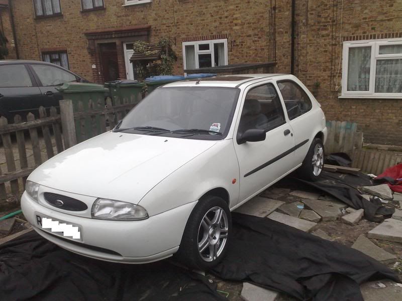

    ford fiesta 1.25 zetec :D
    what yous think?

    i need to hurry up and passed my test im tempted to drive it lol but its got an annoying tapping noise and leaking brake fluid from master cylinder :( anyone know about cars loool
  13. wobbly_trials
    tapping noise is most likely valve clearnces and the leak is either a gasket or a brake pipe.

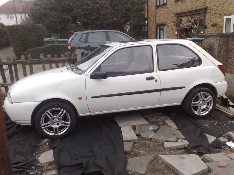

    ive done valves on a 8v car before in college but with 16 theres two cams (i think thats what there called) and ive been told that makes it harder :confused: ??????
    fluid is leaking from the master cylinder from where it connected to the rest of the system but i cant seem to be able to pull it off :( i think the seals just moved/came out of place.
    any ideas
  15. wobbly_trials
    if its on buckets and shims it'll be a nightmare to do. i would immagine it will be. 16v are only harder because there's more of them and twin cam are harder because there's 2 cams to time.

    infact the oil is really low. so tomorrow im taking a trip to halfords to get some along with brake fluid and new seal.
    if it doesnt sort out the noise ill have to attempt the valve my self :( with some assistants from the internet :D i havent got the money to pay someone hundreds of pounds to fit a £9 part :msn1: lol

    Get yourself a haynes manual, you'll need it anyway for timing the cams, unless you have access to autodata program or something. Im not trying to be a prick or anything im just saying you could do more damage using the inet instead of haynes manual.
  20. wobbly_trials
    clearances can be done with the head in place. may have to remove cams (can't remember on that motor).
    would be worth dropping a cam belt on it at the same time.
    don't use halfords oil. get something half decent.
    oil
    filter
    plugs
    cam belt
    air filter
    and sort your brake leak.
    fair service really.
