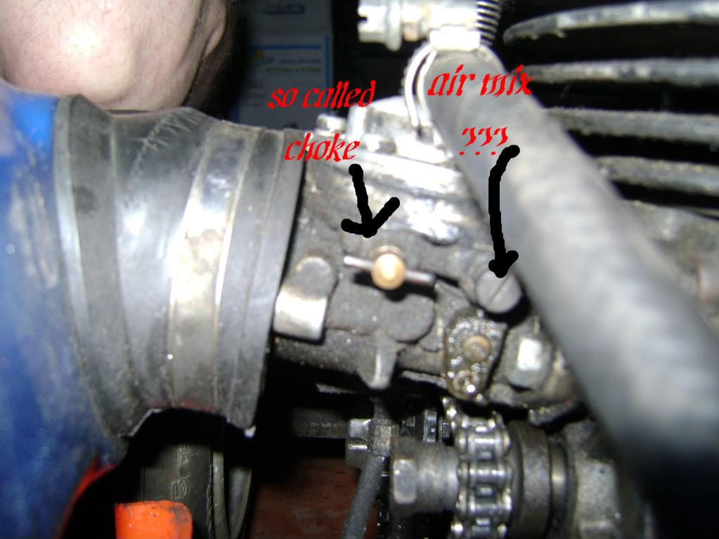

    right got this 100cc kart the boy who a got it off said that was the choke but isit jus the idle never ownd a gokart b4 so im new but dnt seem like 1 and wats the other 1 air mix [​IMG]

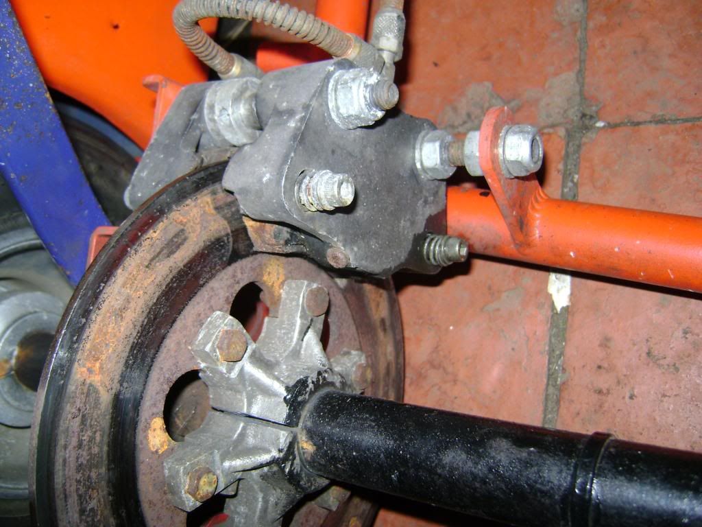

    and ne 1 no were the brake bleed nipple is bit wired as the brake line gos to eva side of calipar jus thought see if ne 1 ne gd on here b4 i go ona kart fourm n look like a numpty lol

    no, there 2 mix screws, the small one is idle the second is full throtle, the carb itself decides what jet it draws through..
    setting them up is fairly simple, can check youtube vids for "carb tunning chainsaw" all the same old shit.. full throtle, wind the screw to the point its revving the cleanest then make it rumble slightly...

    cheers for the help sorted it now there hi and low jets
