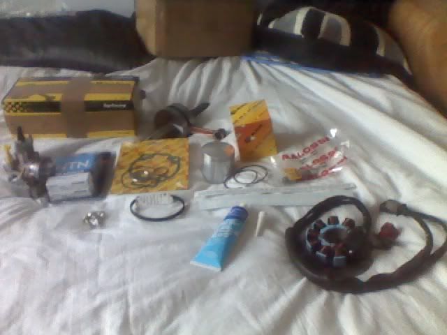

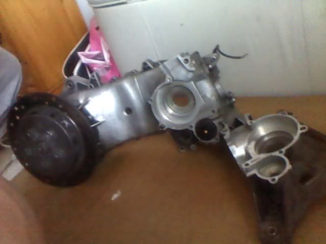

    quick update: got the engine cleaned up and took a picture of the some of parts that are going in it. ill get some pics of the frame and pannels when the weather clears up a bit :good:
