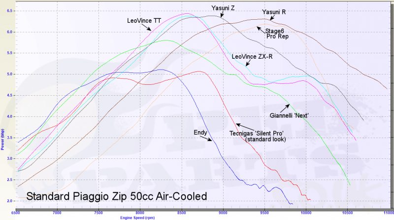

So i have these parts on my gilera storm Has these parts in it Stage 6 pro rep exhaust Stage 6 4.3/3.7 gram rollers Stage 6 foam air filter insert Polini hi speed variator Polini Evolution Kevlar belt Polini torque spring Polini 3G Race Clutch(polini green springs) 68 Main jet Full throttle of the line it goes to 6,000 then hangs most time especially on hills and upward slopes I need help what to do , do i adjust the clutch to engage at 7000 rpm or 7500 or around there as thats were it builds power and has enough power to propel itself of the line because nownit enages about 6,000 rpm which is 2bhp which ithink is no were near enough to get the bike going so it can build up to its peak 9,000 /1050 rpm ? Please if someone can help id be greatful
