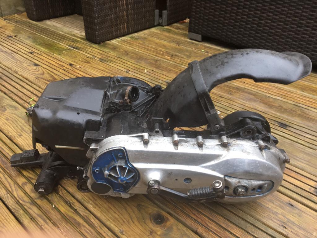

    Its absolutely fine to not have that plastic cover on as the metal one will still be there to protect it afterwards, the only reason piaggio shipped them covers with gileras and italjet etc was to remove the piaggio branding , the piaggio typhoon is based on the same engine and does not come with those covers.
    obviously dont take off this metal casing as the transmission probabaly would not be happy then, there will also be that plastic intake cover to get and if its a rolling nut there will be a second plastic cover at the clutch nut, other than that you shouldnt have a problem.

    That looks awesome. Is that a SP 180 2000 to 2006 ? as does not look any thing like me configuration.
  7. seancullen
    seancullen Member
    127
    et4 125,px80,dna50
    its a non rolling nut air cooled 125 in a piaggio typhoon, the bottom end and casings are the same for all the piaggio 2 stroke automatics above 125(including gilera italjet aprillia models etc), the only difference was the change from non rolling nut to rolling nut.
    this is what rolling nut wil look like, can be run like this but better to get the plastic covers for the rolling nut and the air intake like i mentioned in my last post.
