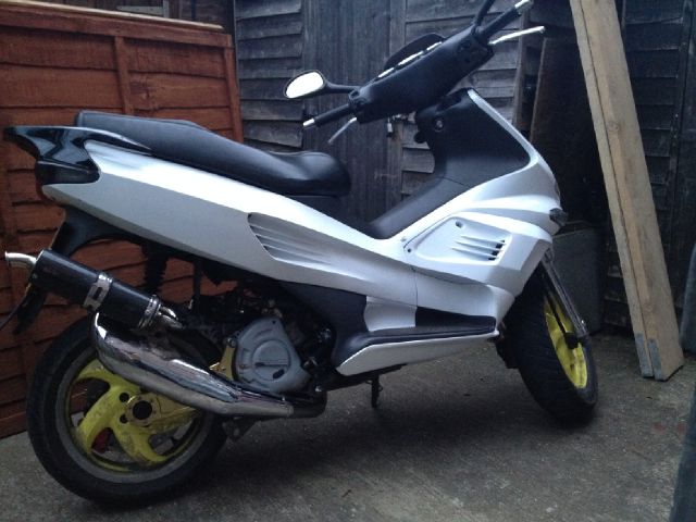

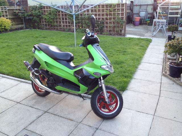

    hi i got a problem with my gilera runner 172, it doesnt seem to want to go faster than 70mph?
    ive got:
    ported 172 with gold billet head
    malossi 52mm crank
    pm tuning variator with 13g rollers
    malossi belt
    polini clutch with pm tuning clutch bell
    primary and secondary gear up kits
    delorto 25mm carb with 105 main jet, 50 (the small 5mm jet), 60 pilot jet i think? the long 1 and dunno the other 1
    malossi air filter
    pm tuning manifold
    malossi reed block
    malossi cdi unit
    pm 360 pipe
    koso clocks
    the problem i have is when i get to 60-70mph that bike dont want to go any faster which it should because my old runner didnt have half the parts this bike has and that did over 100mph on road?
    can any1 help with any suggestions? thanks
