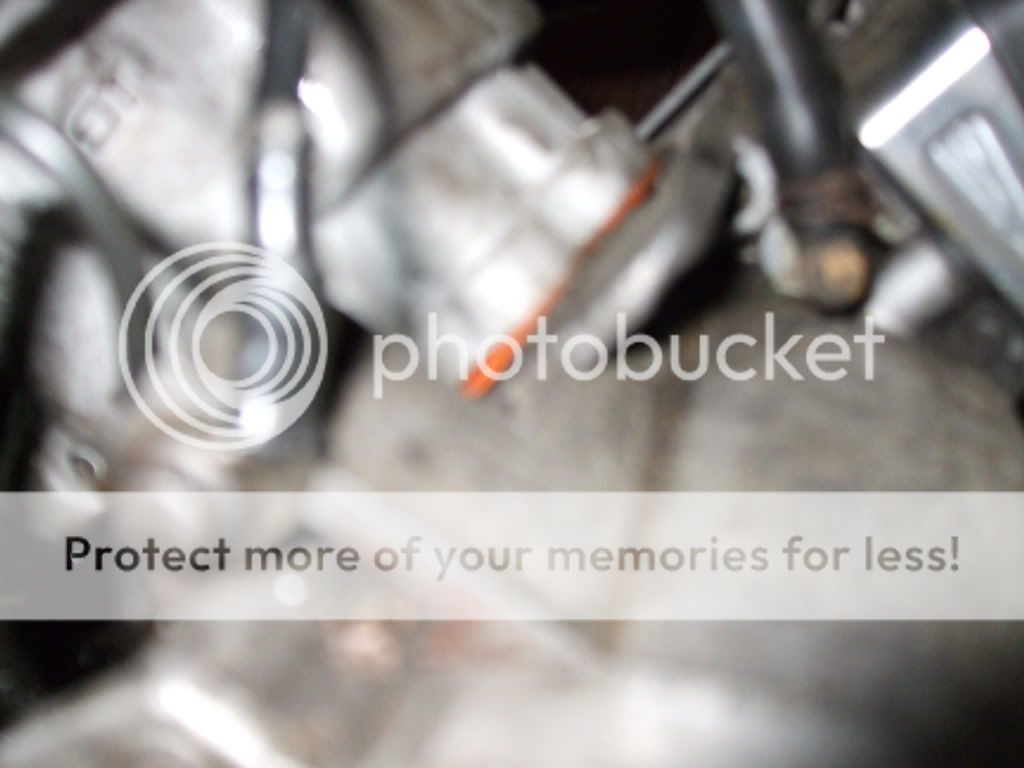

    Runner 178
    Sorry for the bad bad quality! you can just make out the base gasket used for a 54mm pm crank.. its a load of them card gaskets used.. This is surely not ideal and should have a aluminum 1.5mm base gasket? It runs fine and all but im thinking of getting a new 172 engine and thought obviously cant use them as gaskets again so i should get a 1.5mm ally abse gasket. Just checkiing with you guys as you know more than me, Again sorry for the bad picture but im sur eyou can jsut make it out.
  2. tErr0
    Should be a 1mm spacer. That picture is far to terrible to work out what's going on.
  3. Grunner183
    Grunner183 Member
    69
    Runner 178
    Ahh soo with a 54mm crank its 1mm? Cool thanks :D. Ah well you can see theres the mallosi bore kit.. and the orange stuff is the card base gasket.. terrible like i said.
