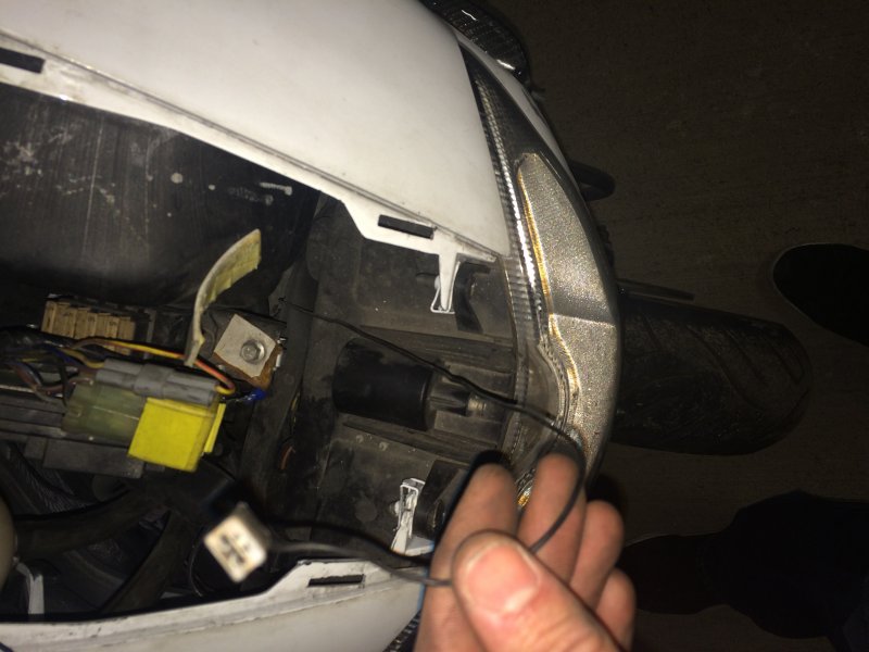

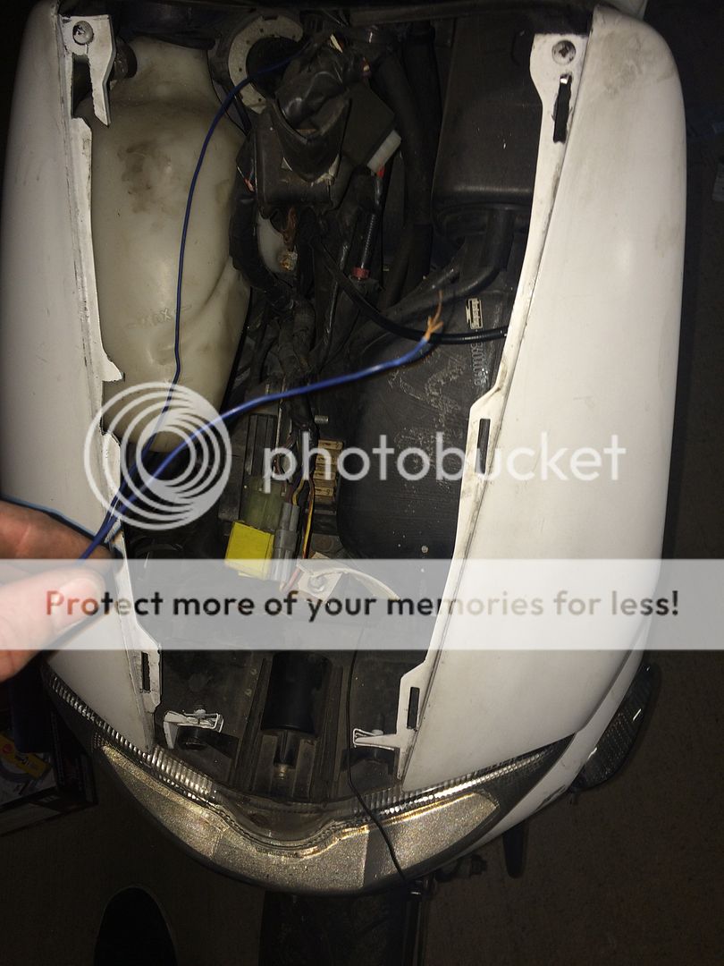

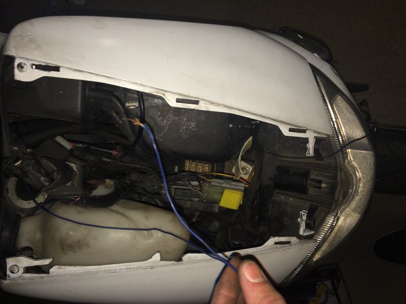

    Someone tried to steal my runner vx 125 and they removed the key barrel. They also removed the front panel and disconnected the bigger plug out of the 2 which connect onto the CDI. The Cdi on my bike hasn't got an immobiliser, as I bought it like this from the dealership.
    I re connected the plug that the thieves took off the Cdi but I've also come across 2 broke wires (see pic).
    I've installed new battery and spark plug and but I have not getting a spark from the spark plug cap when I disconnected the cap and try to start the bike. So I'm assuming it's cdi related or something to do with the 2 broken wires which I don't know where they connect to.

  5. Stevep
    Check the back of the ignition switch, where the key goes in.
    There is a 4 wire connector that goes to it, they may have come from there. If I remember rightly, connecting two of those wires alone will also light up the dash.

    Thanks will have a look. It could only possibly be the blue wire in the top pic that could of come out of the ignition switch as the other black wire has a female connection on the end which looks like it plugs on to somewhere. Looks like it's coming from the headlight area.
    Also, I wouldn't need a new CDI would I? As it's still the same Cdi and all the thieves did was disconnect one of the plugs on it
  8. Stevep
    Highly unlikely you'll need a new cdi
