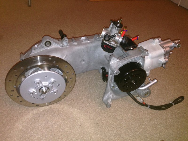

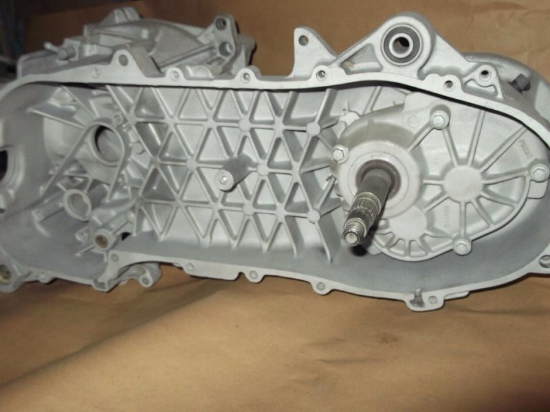

  15. Mefodi_180SP
    Mefodi_180SP *GILERA*4*LIFE*
    18
    Gilera Runner 180SP
    The sand blasting was done on the casings before I bought it.
    I bought it from a guy who had the casings flowed and sand blasted, however he never got around to using them so sold them.
    The flowing and sand blasted was done by a 2 stroke tuner: MGT / Mario Gilera Tuning.
    He has a work page on Facebook, look him up good guy and reasonable prices. image.jpg
  16. turbovetto
    turbovetto Well-Known Member
    1,561
    tweaked ovetto
    nice work. Looks like theres been a bit of repair of the surfaces. Use good sealant when you rebuild. Not that blue shite.
  17. Mefodi_180SP
    18
    Gilera Runner 180SP
    I've actually already finished the build, and I actually did use some blue sealant didn't know it was of bad quality?
    Looking to run the engine soon but want to sort out the whining noise out first though... So close but yet so far haha image.jpg
  18. turbovetto
    1,561
    tweaked ovetto
    If you did it right it will be OK. But red CAFF is where it's at.
    Nice looking block. Never seen cleaner!
