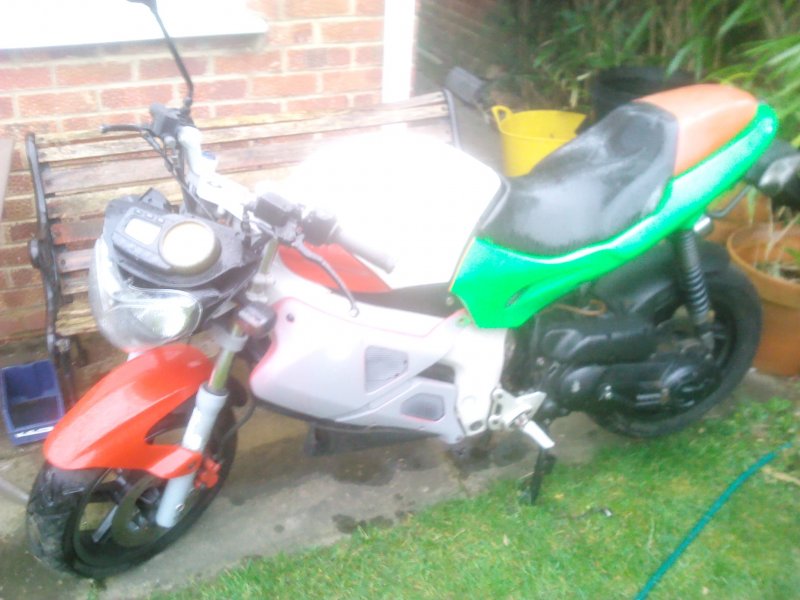

    After months of messing about I finally bought the bike, it's in shit condition.
    Problems so far:
    No keys
    Slushy stuff in lc
    Some of the fairings are cracked
    Fake petrol tank hinge is snapped
    Speedo is cracked
    Paint job is shit
    Btw does any one know how to start it without a key, I saw a post on hear saying you have to disconnect the white box coming from ignition. And kick start it but nothing happening when I try?

  2. Sketchytom
    Sketchytom Roach
    208
    Rally 50 you get me
    i would like to know the insperation for that paint job :)

    theme is probably italian flag
