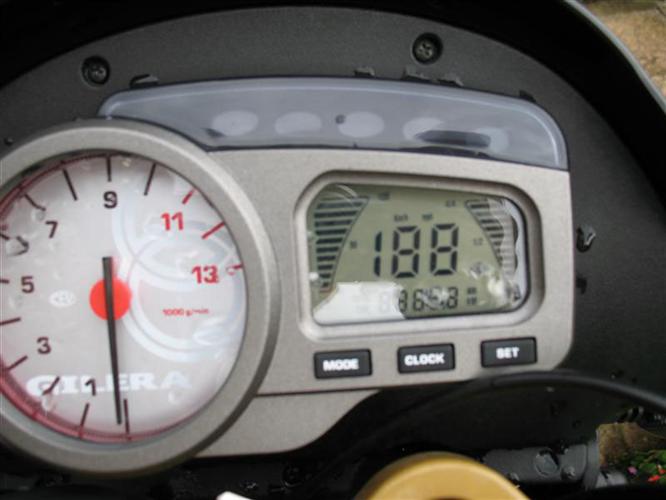

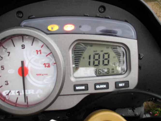

    I just got a Gilera DNA 50 in mint condition. Problem is the previous owner (a friend) said that the battery was flat and that was all that was wrong with it. When I got it home, I put in a new battery and when I turn the key to ON the lights on the instrument panel flash to a tick from the rev counter and the needle bounces about 5mm. When I put the battery in I noticed that it looked to have had an after market alarm/immobiliser installed as there is a socket lying there. On further inspection I noticed that a lot of the wiring loom has been wrapped with insulation tape. Some pictures I have taken below of what is looks like when ticking on/off.
    The bike turns but just does not start. The ticking continues. When I switch it off, the instrument panel ticks madly for about a second with the boucing needle and stops.
    Any ideas? Is this a normal feature of a DNA if there is some problem? Is it the left overs of the alarm/immobiliser doing this? I have no idea when it comes to new scooters.

    Ok, I finally got a chance to take the panel around the clocks off and no relays at all. Turned the ignition to on whilst I had the clocks in my hand and it is definately the clocks making a tick sound every second, everything on the LCD display showing/lit and the flashing fuel and heat lights still going. If I turn the key to off (and it makes the rapid tick mentioned previously) and then quickly turn it back on before the ticking stops (as it only does it for about two seconds) the ignition comes on normal, with the lcd looking normal, but only for around 10 seconds and then it goes back to before with the ticking, flashing lights, etc.

    So some progress. I managed to fire the bike up, seems to run beatifully. The clocks are now even worse, they tick even when the bike is turns off now. There are now two different ticks. When off just petrol lights ignites with a repetitive tick, a second on and a second off. When on, there is the same old tick every second with the petrol and oil lights on. Both are repetitive and do not stop. I have systematically unplugged everything while this tick is going on and nothing stops it unless I unplug the red plug under the fake tank cover, but I guess it only stopped as I disconnected the power to it.
