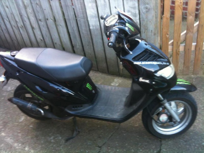

    it's got a tecnigas exhaust, had new piston, barrel and rings etc. in september last year.
    right, the problem is, all of a sudden, its doing 18mph up any slight hills?
    normally it would fly up a hill touching 40mph, does about 45 - 48 on flat.
    replaced rollers and belt last week, the old rollers were flat, but it still wont pull?
    Really annoying me now since i live on a hill, and have to go up a tonne just to get to sixth form each morning-.-
    any help would be highly appreciated, cheers lads & lasses
