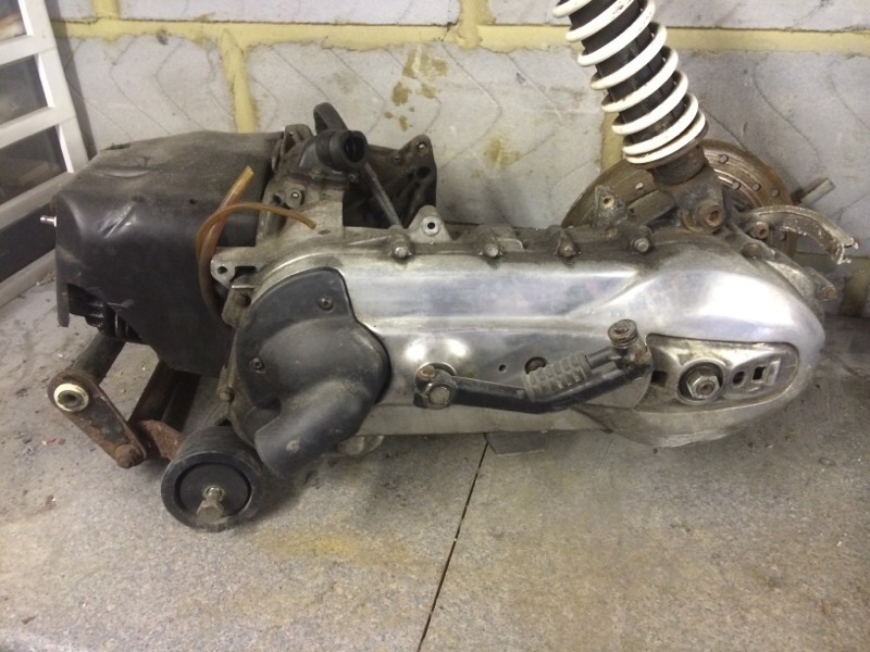

    I have been wondering if I can fit gearbox from 180cc Runner into my 125cc Aprilia SR. But I have been wondering if there is difference in final shaft length/shape. I have drum brake, but 180cc usually have disc brakes. Are they replaceable without press?

    Rolling or non rolling clutch nut?

    Damn, You got me there, I dunno, how Can I check it?
    EDIT: Does it make a difference?
    EDIT: What difference it makes?
  4. MARSH
    MARSH Whooooo!
    3,266
    Piaggio Typhoon
    You need to know engine type they are, yes there is a difference.

    You have the early "non rolling nut " engine, the gears from the top picture won't fit. You could get a complete 180 non rolling gear box and fit it straight in!

    i belive all transmissions can be fitted in each engine case, i experimented with diffrent gears from skipper hexagon and runners.
    as long as u dont have a dubbel roled engine cover you can switch al the gears.
  9. zipking
    zipking New Member
    9
    a primair set of gears need to stay together aswel as a secondair gear set. but you notice it easly when you try to fit 2 wrongs gears.
  10. zipking
    zipking New Member
    9
    well sorry for my last mesasge, i found out the hard way that you cant put a dubbel rollend primairy shaft and crankcase cover on a single rolled engine... bought the parts for nothing
