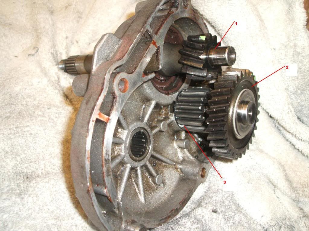

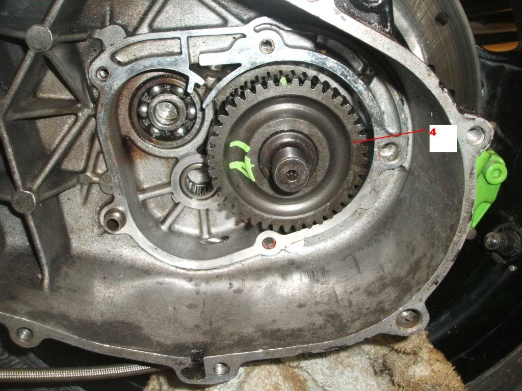

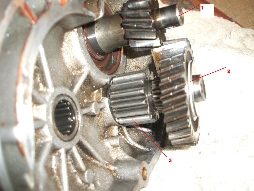

  4. iang
    iang New Member
    20
    I stripped the gearbox today to have a look at the setup as the scoot seems really tall geared!! Now from what i can see as i've never had a auto box apart and please correct me if i'm wrong !!
    1 and 2 are the primary
    3 and 4 are the secondary
    What ive found is that gear no 2 has a piaggio stamp on it and i persume this is standard..so ineffect a standard primary ??
    As regard to teeth...
    gear 1 has 13 teeth
    gear 2 has 30 teeth
    gear 3 has 14 teeth and
    gear 4 has 41 teeth.....
    Can someone tell me what set-up i have here as i have been told it may be a hexagon engine/gearbox...
    any advice would be appreciated.. :beg:
    Cuki_88 likes this.
  5. tErr0
    Well for one malossi don't make a primary gear up. Polini do so if it was an aftermarket one it would be marked.
    What gears you have pointed out are right. 1 and 2 are the primary gearup and 3 and 4 are the secondary. 3 and 4 are also straight cut so this sounds right as malossi gears are straight.
    14/41 is totally wrong though. The gear ups they sell are either 14/43 or 15/41 so maybe you have got half and half from two different kits...? Could explain the weird goings on.
    I'm not sure of the stock numbers so I couldn't tell you what the primary is out of. If it's a 180 or not.

  11. tErr0
    Piaggio seem to do a 125 gear that is 12/30 but it's gear 2 and 3 in your pictures. http://www.scooter-center.com/scowe...IO:A_PIAGGIO_TPH125&category2=CAT:CAT_ANTRIEB
    So according to all the information you have been given then your gearbox is...
    gear 1 has 13 teeth = piaggio 180 input shaft
    gear 2 has 30 teeth = piaggio 125 gear
    gear 3 has 14 teeth = Malossi out of one secondary gear up.. 14/43
    gear 4 has 41 teeth = Malossi out of a different secondary gear up... 15/41
