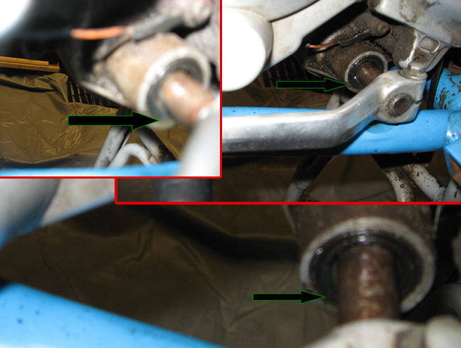

    Below are some pictues of an oil leak on my aprilia rx 50 2001 model.
    im guessing the oil seal has gone?
    could anybody tell me how i would go about replacing the seal, thanks
    the arrow on the diagram indicates where its leaking from.

    think you have to take gear box off mate to get to it i had a reiju smx before and i did it that way unless u can pull seal out then slot new one on

    just pull the shifter off and then take the seal out by putting something between the seal and the shift rod and pry it out....maybe sure to lean your bike to the other side so no oil comes out. then clean it good, rub some clean oil on the new one and tap it in place with a socket

    can pull it out using a self tapping screw
