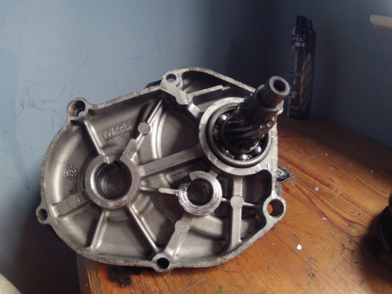

    need to press the bearing out take it to a garage with a press, shouldnt be too explensive as you have stripped it already.
  3. patwk03
    patwk03 Member
    79
    yam neos 50/yam cw70
    will the new case need repressing then?
  4. 2many2strokes
    261
    zzr1400
    if you take both cases they should do it there and then, some bearings can be stupidly tight. my 406 coupe wheel bearing took 10 tonnes of pressure to crack!! this may sound silly but have you tried to heat the case in the oven? getting the metals to expand slightly might help. if i remember correctly ali expands quicker than steel
  5. patwk03
    patwk03 Member
    79
    wow 10 tonnes thats insane i might try a heat gun on it but i havent got the new one yet so i will take them both at the same time thanks
  6. 2many2strokes
    261
    zzr1400
    thats ok if you do have a go at heating it yourself remember ali melts at half the temp of steel

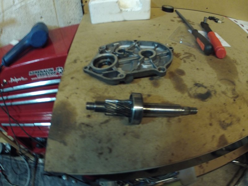

  7. scubabiker
    we just use a heat gun at work, heat it up around the bearing, and keep spraying it with penetrating oil, then just tap it out, then put your new bits in while its hot (or let it cool clean it then put your new stuff in)
  8. patwk03
    patwk03 Member
    79
    ah success the trustyheat gun and wd40 came out on the first tap :D GOPR0003.JPG but how do i get the bering off ?
  9. scubabiker
    same way you got the part out the case, heat it and tap it
