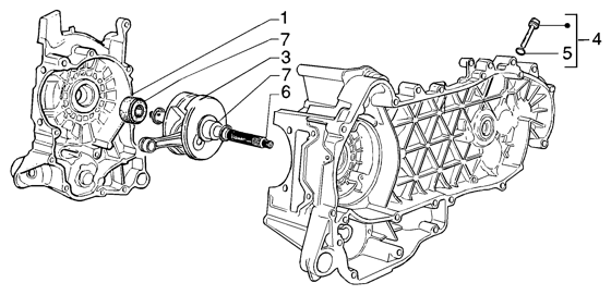

we thought we would give it a go the engine the kit springs valves and cdi the cam http://farm4.static.flickr.com/3641/3489162184_4b9bb9be52_b.jpg the carb the crank wanting to do it on the cheap forget it that lot cost the best part of 2 grand whats in there then lol the unreplaceable "bearings" lol they are ok on this one the head where it all matters ? waiting on gaskets and guides and then back together again ,should be interesting ?we will keep you posted with the build and bring you the what the dyno says ?
should be interesting. and surely they are replacable ? just shell bearings or you taking the piss ? (hence the lol)
thats what everyone keeps telling us even mr haynes says so ??????man put em in there we cant see any reason why man cant replace em ?

yeah i would say they are. same as any other 4t engine like the cars. they have the same shell bearings. they should have like a little hole in the middle of the shell for oil and oil comes through and creates a thin film of oil. they shells are on the inside are very soft metal(can scratch it with your finger) that like soaks up little metal sgavings etc. sure you already knew like buy hey lol cant wait to see it runnning though
ye all this nonsence wiht the whole "the bearing is the case, its machined in and if its fucked its fucked" fact is haynes asked piaggio for a replacment part, they wont sell them.. thus rendering the cases irriparable.. christ the engines would be more reliable/last longer than a c90. when would they ever unload more moddels... ye there just pressed shells. fact is nobody list's them, but SOMONE fuckinwell made em so ye, wont be too difficult to scorce/make im sure. so many people just chat shit/among themselves rumors ruin practice. ANYWAY its going back together as soon as gasgets/replacment parts are in altho it came apart pritty easy once we persuaded the road salt soaked gasget to let go.. will be interesting to see what it puts to the wheel ether way. lookin forward to doing the head (well half of it LOL)
