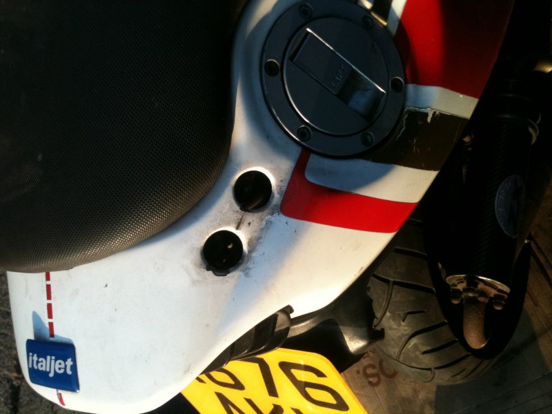

  1. jamespee
    jamespee Member
    90

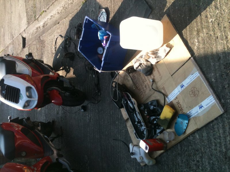

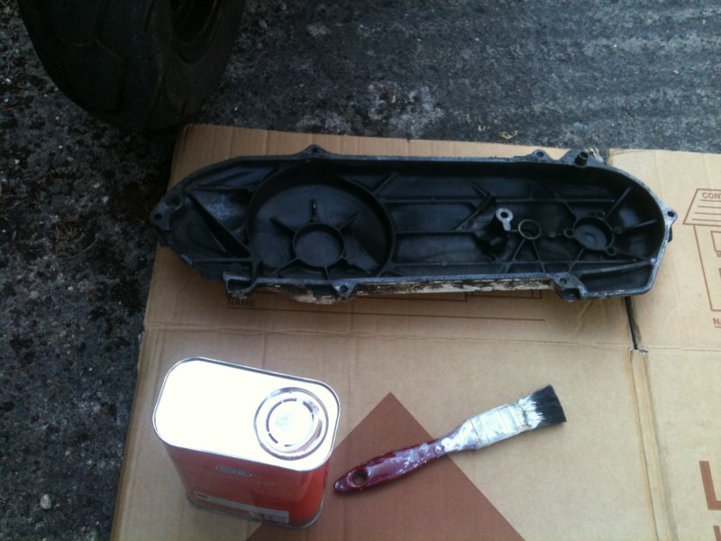

    cleaning process with liquid cleaner brush and sponge
    cleaning the box or spares

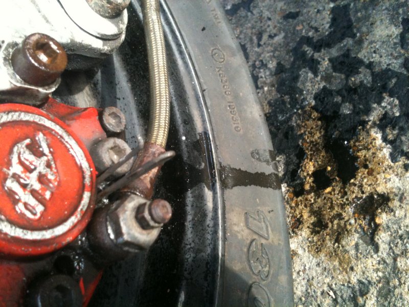

    13/6/2013 now cleaning brake disc callipers with a nail brush
    Made good progress , now searching for some better nutts & will redo the threads with a tap

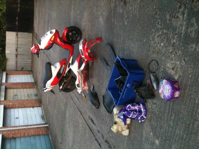

  4. jamespee
    jamespee Member
    90

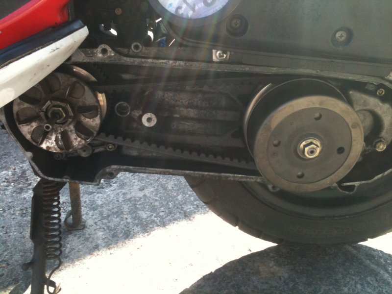

    This is now alot cleaner and I see the tension on the belt has lowered . There was'nt a gasket set

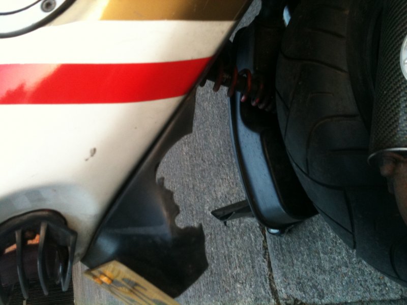

    Look at how this was , !

    that cleaning stuff made the bike roll easy

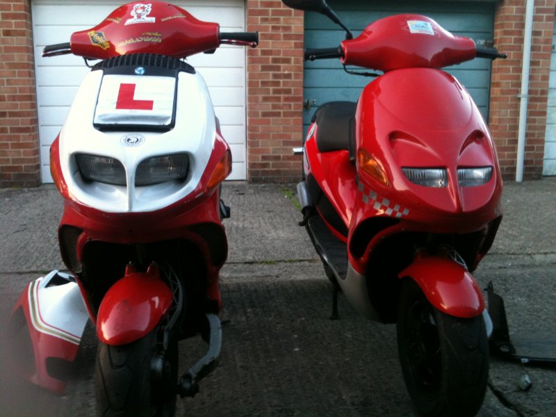

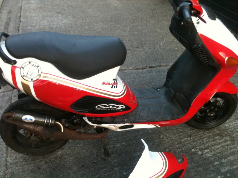

    Anyone know whot other body parts fit
    Place links below , /

    The electric start is moving crank but it isn't firing up
    Also the throttle is loose !
  10. jamespee
    jamespee Member
    90
    Tested for spark & there is a spark
    Took off air filter covered with
    fingers to check carb was working
    As petrol did start to come out !
    Throttle cable is still sticking so will
    Take off carb to clean
    1 oil hose
    2 petrol hose
    3 rubber hose , see whot colour it is inside
  11. jamespee
    jamespee Member
    90
    Maybe cylinder head has gone
    Not a lot of compresion
  12. jamespee
    jamespee Member
    90
    Took carb off noticed Carburettor throttle return spring dry and worn out
    Tipped liquid out of floot
    Cleared the jet with the needle Now is see through . Un blocked
    started up .
    So now checking cooling thermostat for the open position hopefully
    Valve will open before boiling point .
    Checking the make of brake pads to order fresh !
    Looked for two wires on radiator but couldn't see any
    Drain radiator hoses
    Fuel. Check vacuum opens diaphragm inside tap
    Re fit new filter Order with brake pads !
    Next check air filter
    Measure the resistance between the terminals on the choke unit
    & plunger hasn't seized

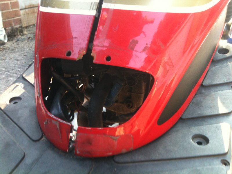

    im pretty sure that's meant to be like that the way it splits so panels are easier to take off ?
    just change the hoses and get a quick action throttle there a lot better than standard I think.
    if not a lot of compression id be looking at piston rings and gaskets etc not the head itself at first.

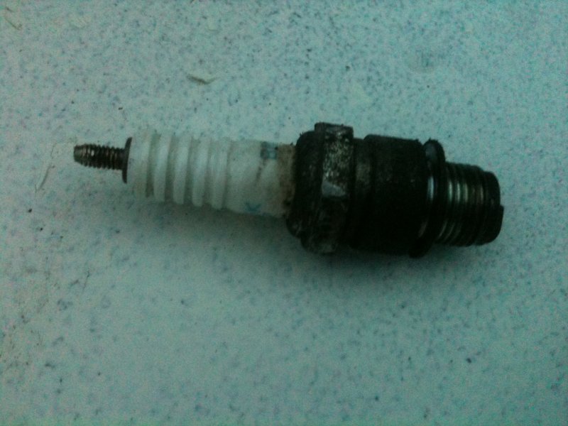

    spark plug

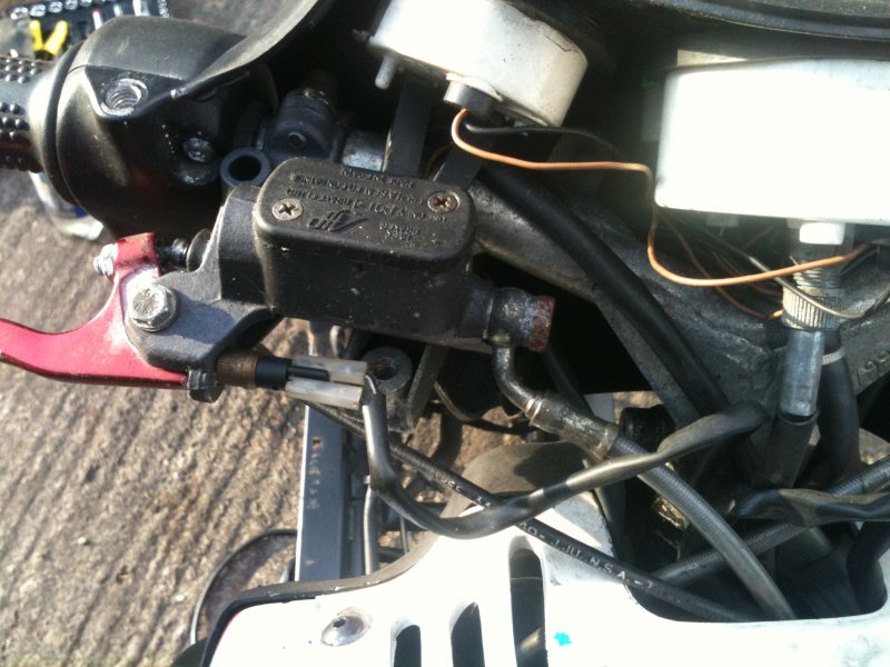

    removed the handle bar covers ready for loading fresh oil need new sealing washers .Lift the reservoir away from handlebar attach a clear hose to the bleed valve bleed valve carefully pump the brake lever 3-4 times tighten the bleed valve then release the brake lever gradually .may use a syringe to avoid troublesome air locks​
