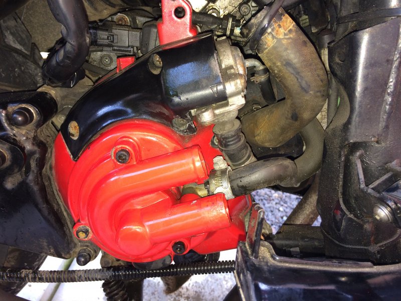

  8. JoJo
    JoJo Active Member
    671
    Honda MSX
    Here is it so far, just taking the plastics off and 2 pipes,
    i've taken the bolt off from underneath which I put in yesterday as it was missing,
    the 1 thats out but 'still there' I still cant get to,
    theres another 2 that I can see which are actually in...
    So what now, undo the remaining bolts and take the other pipe off and then take the whole Cover off? (red part in the photo) to check everything looks ok inside?
  9. MARSH
    MARSH Whooooo!
    3,266
    Piaggio Typhoon
    Yes, take it off and have a look!
