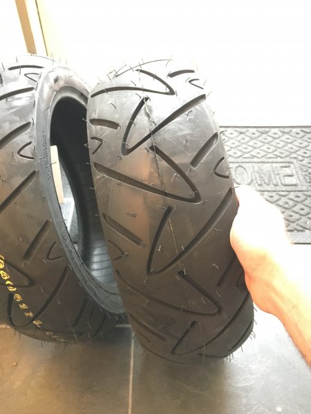

just got my self some very nice conti twist tyres from the Netherlands for a very nice price for the Malaguti as I haven't got the confidence in the maxxi tyers I think they may be a bit dry rotted I'm sure but any way I'm more than qualified to fit them my self so I was just wondering if any of you guys can recommend a safe home brew tyre soap to ease the fitting process and any tips maybe ?
