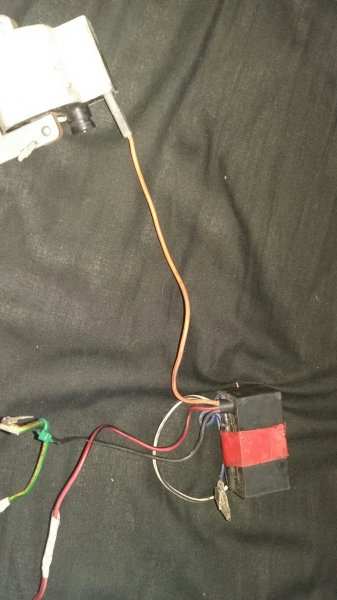

Orange wire goes from CDI to coil Red wire goes to red on stator Connect black to earth aswell as yellow/green wire

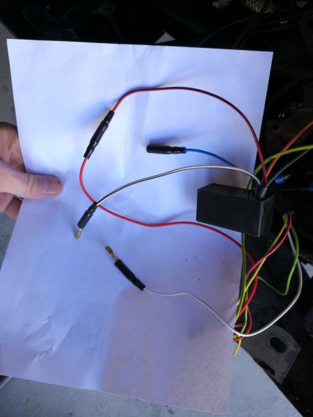

I've got a piaggio zip with c one malossi engine. I've connected the ones you said. I'm left with white a blue and a black/ white what are they for? White coming from cdi. Other two from
Also the supplementary cable coming off the main cable the connectors didn't match so I removed them. Not sure which ones got to corresponding with.

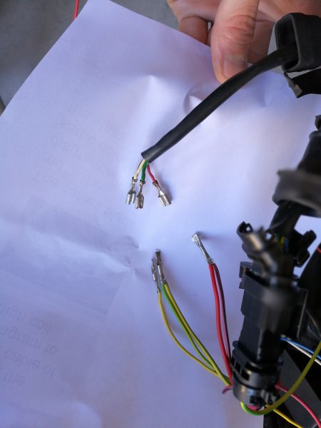

The main connector from scooter fits but has 6 pins but the the connector from Doppler only has 3 pins does this mean some are not needed or strating circuit etc.
on the zip 50 cat , the zip SP and the zip from 1993 to 1999 , the white wire from CDI goes to the stator . you can find schematics here : https://www.scootershack.co.uk/threads/piaggio-scooters-wire-schematics.38206/
