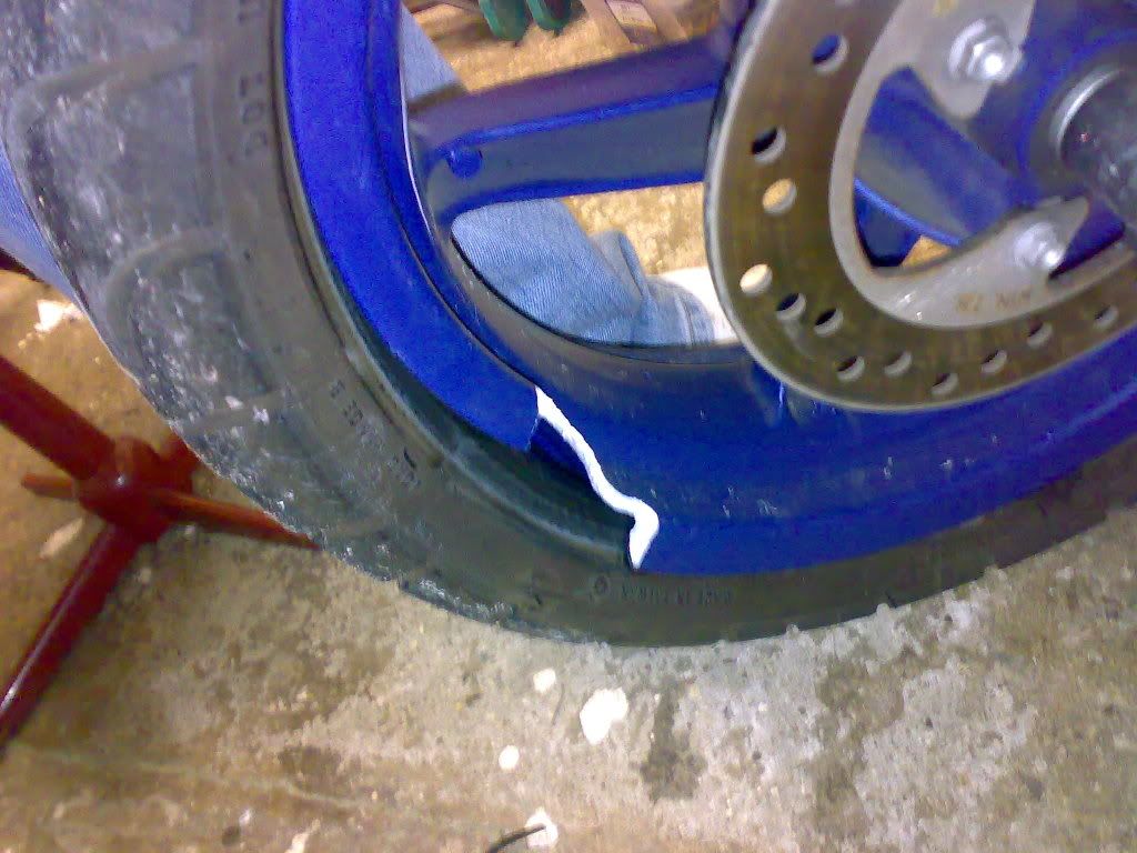

  13. wobbly_trials
    jesus, the photo update tells me you did hit something
    think you might want a new front wheel. ;)

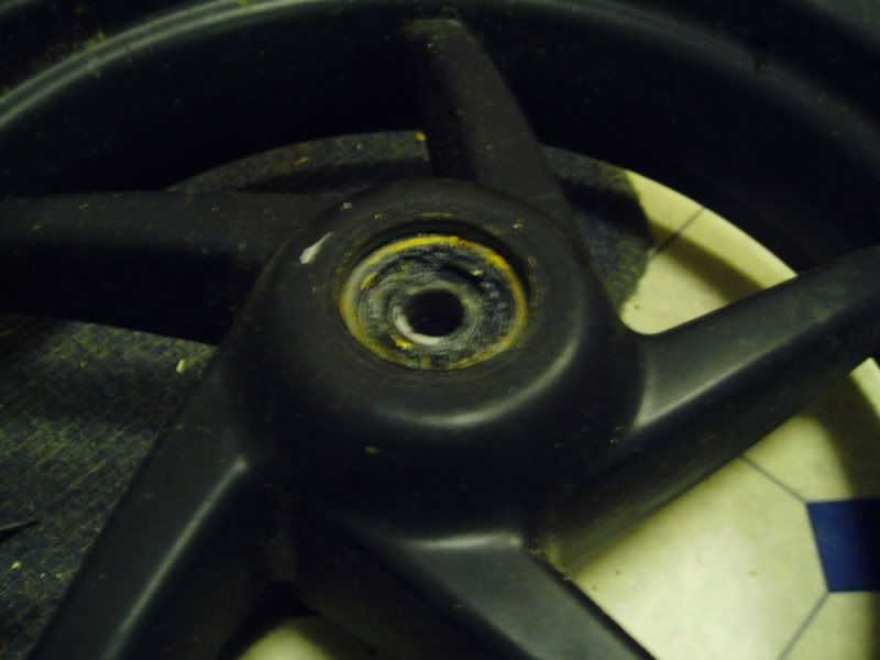

  18. alexsr70
    alexsr70 New Member
    2,039
    could you get me a pic? or anyone with a pre 2004 sr50/125 wheel laying around?
  19. wobbly_trials
    yep
    1 sec...
  20. wobbly_trials
    crap quality but you can just make out the small metal lugs.
