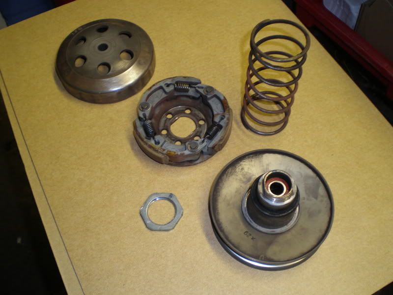

    I've got an Aerox clutch sitting on my bench. Want it?

    is it standard clutch ?
  17. px166bajaj
    px166bajaj Active Member
    1,367

    how much u want for it mate, ill let you know tomorrow if i want it cause im putting a new belt on and gonna lube everything up

    Or a tenner plus postage. (I'll reassemble all that lot before sending it) PM me if you want it.
