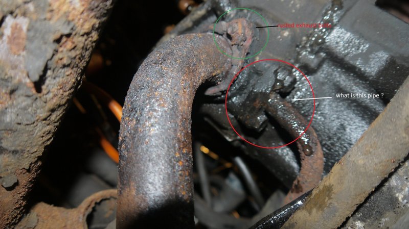

    hi guys, so im trying to get the head off my aprilia atlantic 125 and i cant get the exhaust off as the nuts are rusted away and unrecognisable as nuts..they are meant to be M7 so 11mm i think....
    anyhoo, have you guysa any suggestion as to how to get them off ? there is very little space to work aroung them, very hard to get to :(
    also, on taking pics i see a pipe i cant ID, what is it and will i have to remove it
    Through a rigid, flanged duct connected to the head,
    air reaches the exhaust connector so as to release
    oxygen to the unburnt gases before the catalyzer, by
    thus favoring a better reaction of this last component.
    cheers rob

    cheers, i upped a pic as its well past using a socket.. of any size, i think mole frips but no space, same with cutting or grinding it away,.. nightmare
    i see that pipe in the pic is the SAS pipe, some sort of vent, and il have to remove it ..
    cheers rob

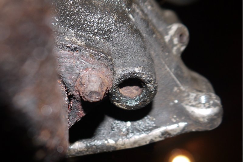

  4. rob b
    rob b oily hands..
    89
  5. Furby
    Furby Member
    41
    Yamaha Neos YN50
    as said above use a wire brush to see if you can get them looking like bolts again, then wd-40 them and leave it over night. Wd-40 them again in the morning and try using a socket or mole grips to remove them.
    rob b likes this.

    On the subject of the second little pipe- it looks to me like a built in catalyser thingy. You might get a performance hit if you disconnect and blank it off with a plate. But check where the other end goes and what it´s connected to. or ask someone who knows what they are talking about.
    I'm clueless with 4 strokes......

    yeah it was an SAS pipe, as you say, its a catalytic thingy..i got that off ok..
    on looking at the exhause closley, it might fit between the frame to get it out after all, but then, the head has to slide all the way up the head studs..hmm.. would you believe it, the allen bolts on the exhaust have siezed lol :D..but they are easy to access, so im working on them..

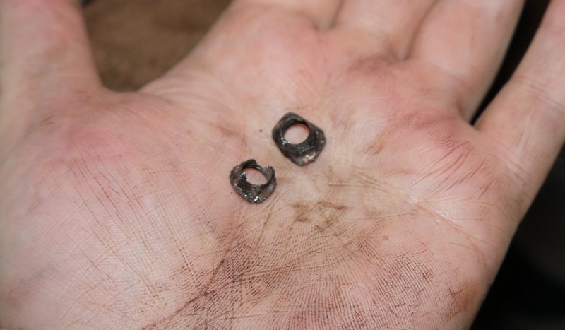

    Well, i got the "nuts" off the head...not much left of them, it was tricky but saved the studs..:) nuts.jpg
    Stevep likes this.
