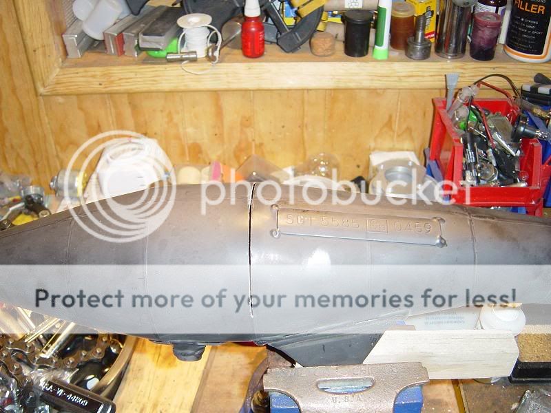

    Leo vince ZX pipes have a sound deadened material inside the expansion chamber. That's what gives them the deeper, muffled sound. To get it out you need to cut it open and re weld it afterwards.
