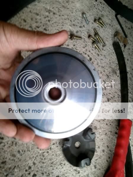

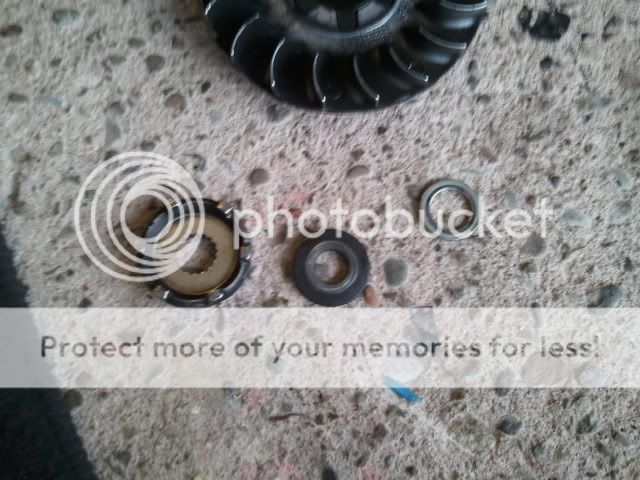

    anyway, the variator looks restricted to me i'll put some pics up for you guys to see and see what you's think.
  11. MiNoR cOnFuSiOn
    draw a line in black permenant marker/tip ex across the pully... re assemble and take it for a spin, go as fast as you can and then check to see if the belt has rubbed the pen off all the way to the top..
    it looks like it could just be marking where the bottom of the belt comes to, if you factor the thickness of the belt it looks about right. altho it may not be reacing top ratio. do the above to confirm

    If the line only goes up to where it is could it be something to do with a restrictor in the variator?
    OR could it be to do with the belt, the guy who had it before him has been wheelying it by the looks of the back end, (where the number plate attaches to) it's all scraped at an angle, so I'm thinking the belts been stretched? As when i took it down the road yesterday after removing the restrictions in the exhaust it flew, however coming back up it struggled and i don't think it even hit 20mph.
  13. MiNoR cOnFuSiOn
    refer to the manual as to what parts should be in there.. could be missing a spacer somewhere
