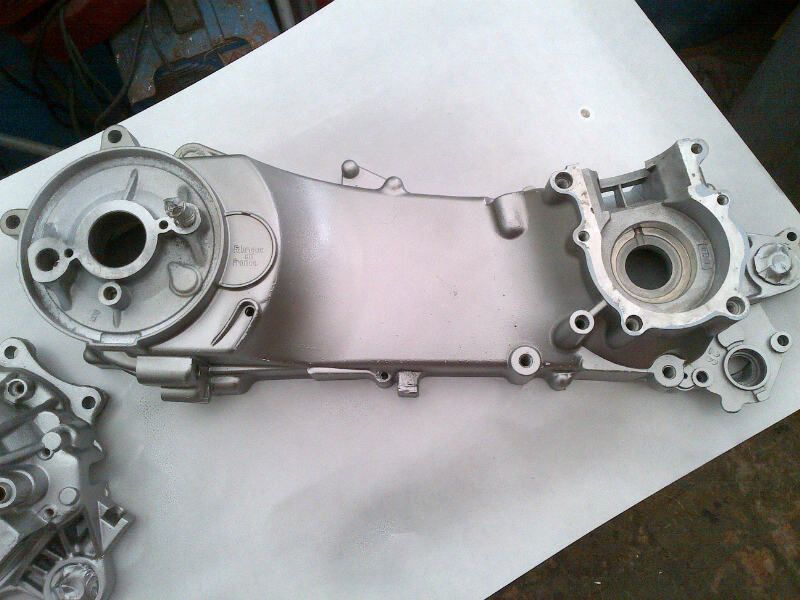

    Jizer brushed on and washed off will remove all traces of oil and grease. Wire wool or a Scotchbrite pad will roughen up the surface to provide a key for the new paint.
    I'm totally OCD when it comes to paint jobs, so mine was alkaline degreased, paint stripped, acid etched to remove oxidation, acid etch primed with 2 coats of U-Pol No.8 then two coats of Simoniz Wheel Steel followed by a couple of coats of lacquer.
    The result looks lush though, doesn't it?
