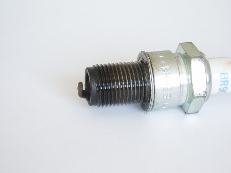

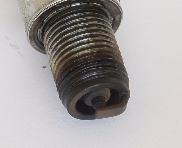

    Does this look ok?
    aerox plug 009.JPG aerox plug 011.JPG aerox plug 014.JPG aerox plug 014 - Copy.JPG

    Looks fine to me. Just erring on the rich side - but that's good. You have no problems.
