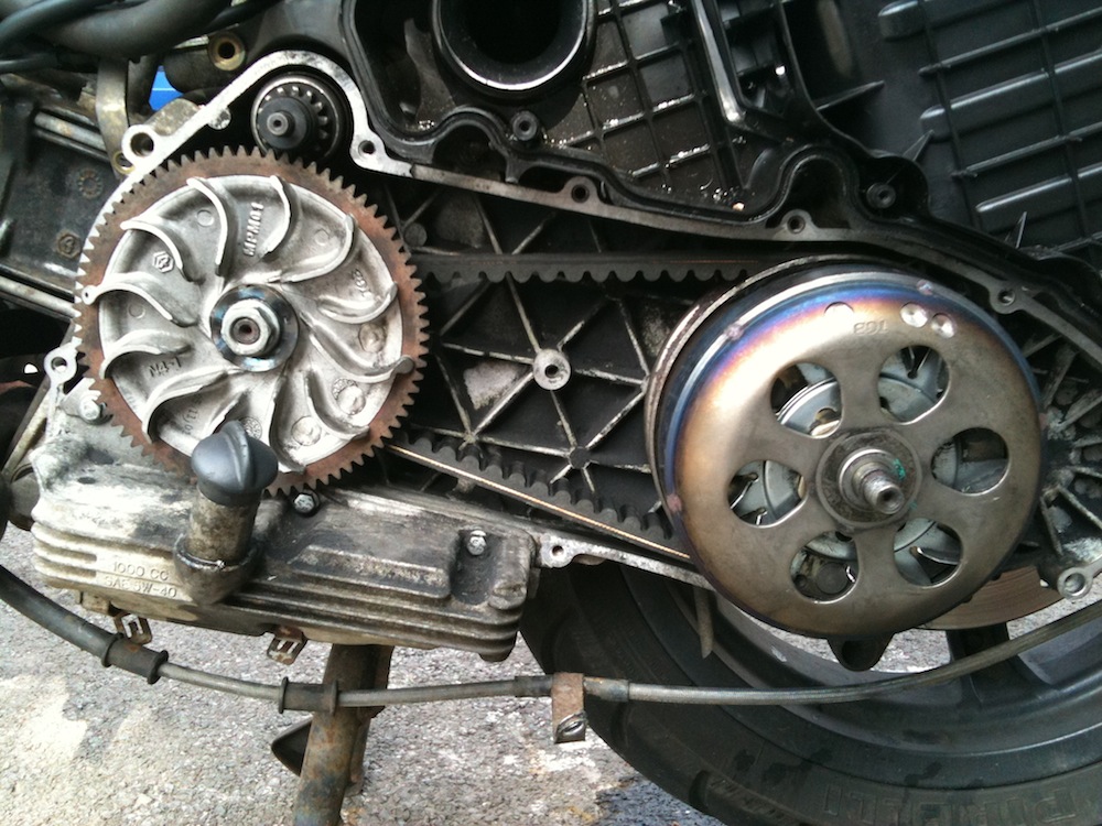

    This might seem stupid and yes I am a lemon, but I need help.
    I went to my local bike store and asked for a Gilera DNA 125 drive belt, I was given one and got it home and its loads wider than the one already on the bike. The one on the bike has only done 1000 miles so should still be fine, the reference numbers on the belts are both different too.... I am stumped.
    Also the new belt is not big enough to fit between the variator and clutch and the old one seems slack.
    Is it the wrong one or am I just being a twat?
    Help!!

  5. Jonnymarrw00t
    3,243
    Piaggio Zip 05 plate
    It's a piaggio engine isn't it ? They all use the differnt belts even though it's the same engine.... Kind of stupid. Take your old belt in and they'll be able to give you the right one, How did your old one wear out....
  6. djsodapop
    djsodapop Member
    31
    Gilera DNA 125
    @Jonnymarrw00t Yup Piaggio. The old one still looks reasonably new..... its a 2002 bike and has done 1000 miles of which 950 were this year. I wanted to change the belt as I am having various issues so thought it was something that I could tick off my list. I will let you know what goes down tomorrow....

  7. Jonnymarrw00t
    3,243
    What are the issues ? Belts generally never go that fast....
  8. djsodapop
    djsodapop Member
    31
    Gilera DNA 125
    I don't think I need to change the belt, but will do to cover that possible issue. I have dropped 15mph on top end and also the A/F ratio is all over the place, so air is coming in somewhere but not all the time. My revs suddenly increase @ 40mph when it should be a steady increase up to 70mph ish being my top speed.
    Teething problems I think.
  9. Jonnymarrw00t
    3,243
    Checked all the gaskets ? Manifold ? Piston worn ?
  10. djsodapop
    djsodapop Member
    31
    Gilera DNA 125
    Nope but I don't think any of those as its only just done 1000 miles. A scooter garage by me had a quick look and said its more than likely air issues, so i changed the filter too.....
    I will see how it fares tomorrow when I take it out for a quick ride.
    It has been annoying me though :)
  11. djsodapop
    djsodapop Member
    31
    Gilera DNA 125
    Right, I did it... I was up early and sorted the whole thing out. New belt fitted and new filter. Now pushing 74mph..... BOOM!!! ha ha I still don't know what the issue was yesterday but its all good now.
