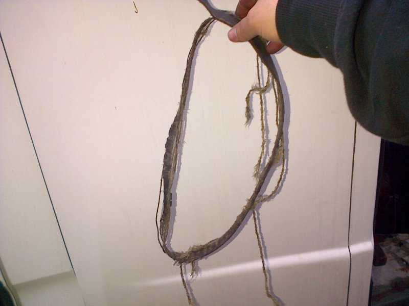

    Just snaped/ripped my drive belt to pieces after doing 45mph just off a roundabout, and need to change it... But I was wondering if I need some sort of locking tool to take off the static pulley sproket.. 'That starter engages onto' to start the ped..
    Its a
    Gilera runner vx 125 53 plate. Thank you.

    Use a rattle gun to take front pulley off. You will need a variator locking tool and torque wrench to tighten it up. 75Nm.

    Oki thanks mate, got all the gear bar the variator locking tool I'll have to order one ::)
